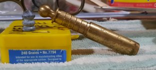

Thanks 243winxb, I want to shoot both, like I said in early post been shooting patch & ball for twenty-five years in a club In Oregon. I saw very few bullets, once in a while some guys show up shooting conical with musket. What I did today, modified 500S&WMAGNUM casting mold, Took the groove out for the Gas check big difference in performance will post shot group but nothing to write home about lol. Before I modified bullets flying everywhere. Now I'm getting crisp round holes. My paper patch rounds shooting just tab tighter group. "Your hundred yards" that pretty good shooting WOW! I only dream of shooting that good at hundred yards lol. It seem I'm doing a bad job trying to show folks my barrel measurement, I found a picture that will help me do so, see attach. Also will attach photo of modified 500S&WMagnum bullet.
Looking at picture the bore of my rifle is measure across the glands, which is .500, across the grooves, is .510 (cut rifling). Bullet is .501, that's. 001 over my bore size. I can start bullet down muzzle with my thumb than seated with range rod with ease. When driving bullet down barrel I can feel bullet engaging rifling just a little that keep it from moving or falling out. As you know when fire Gas pressure will bump bullet up (dia) filling rifle groove. I try Hornaday
Great Plains bullet its top driving ban was .515, with short stick had to pound it in distorting face of bullet for sure. Your attach photo of a bullet is that the one that you are using? Also what is your rifle twist? Do you measure powder with scale? My Iron sights are peep old guys like them a lot, plus using adjustable powder cup to measure powder. Got a cheap chronograph that show shooting 1,170 fps, Thinking now bumping up to 80 grain of powder if my shoulder survive i'll try 90, thanks. Free Trapper

Looking at picture the bore of my rifle is measure across the glands, which is .500, across the grooves, is .510 (cut rifling). Bullet is .501, that's. 001 over my bore size. I can start bullet down muzzle with my thumb than seated with range rod with ease. When driving bullet down barrel I can feel bullet engaging rifling just a little that keep it from moving or falling out. As you know when fire Gas pressure will bump bullet up (dia) filling rifle groove. I try Hornaday Great Plains bullet its top driving ban was .515, with short stick had to pound it in distorting face of bullet for sure. Your attach photo of a bullet is that the one that you are using? Also what is your rifle twist? Do you measure powder with scale? My Iron sights are peep old guys like them a lot, plus using adjustable powder cup to measure powder. Got a cheap chronograph that show shooting 1,170 fps, Thinking now bumping up to 80 grain of powder if my shoulder survive i'll try 90, thanks. Free Trapperbullets-4.jpg
