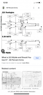

223/5.56 chamber dimensions is a rabbit hole you may not want to crawl into. I have 6 different reamers. The best thing to do is get the prints for the verions you are interested in and see what the differences are. Then pick the one that fits what you are trying to do.
