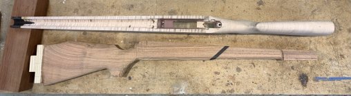

I put some Mesquite blanks together yesterday. The hunk I had was wide but not long enough. I cut on a 45 and sandwiched a piece of ebony between the Mesquite. I dyed some epoxy black and put them together. When I cut the barrel channel, I’ll cut deeper 4” long on either side. for a scab piece to strengthen the joint.C77CD36D-449D-4198-A880-224CB3F55B21.jpeg
Thanks for showing that. I was looking at my walnut pieces and I do have a couple I could laminate together to get the thickness, but not entirely long enough. This technique would work to use those. I have some with grain fairly similar running along the length, that will look exquisite with the right finish on it.
That’s why I posted it. Stagger your joints. Outside in one spot, inside piece 4-6” away. Lots of possibilities. I used a different wood at those joints because I knew I wouldn’t be able to match the grain.

Maple Mannlicher formed as far as it can go until I get my bottom metal. The Ruger end cap wasn’t to my liking so I added some ebony accents.
With that stalled, I put a mesquite blank in the duplicator.8BD3D97A-7A8F-43E7-B229-56FF9878DA08.jpegD5F1F27F-11D2-48AD-82EA-EA438A6DBB0C.jpeg
With that stalled, I put a mesquite blanket in the duplicator.View attachment 1344863View attachment 1344864
Looking good, that maple is going to pop once you get some dye on it.
Have you researched Trans-Tint or Colortone yet?
