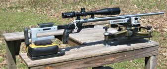

Retired tool maker here, with a heavy foundation in fabrication.
We set up my sons large garage with some machines and a Roto-
Phase to keep them 3 phase. So I get to play now. I like my chassis
stocks, and like to get creative on the mill. This is my latest, I'm
actually taking to match's. It's basically a MDT Oryx that I created
a front bag rider and rudder butt stock. A friend of mine is getting
into 3D printing, so we may have something being created in that
arena. Not shown is the internal magazine block. I do this so I can
utilize the Savage PTA center screw.
