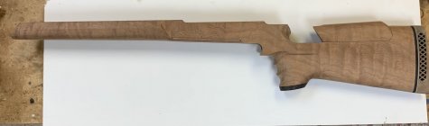

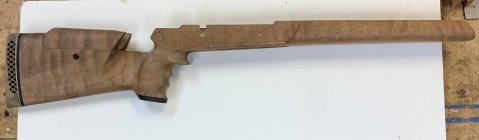

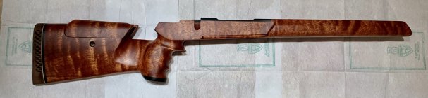

Thanks. I’m playing around with different design elements. I used a 1” radius bit on the bottom of the forend and a 25 degree chamfer on the top. It feels like a beaver tail grip on a shotgun.

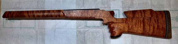

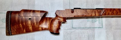

Mahogany is a beautiful wood. Depending on the grain structure can almost have a pearl like appearance from different angles. Definitely give is a lot of depth.
Yup. Even with the first coat of oil, I’m seeing it. I’ve had this hunk of wood in my shop for 3 years waiting for me to get to it. I have enough to do another one. So many projects, so little time!
I didn’t send this one to Bc’z . I think all the curves and dips would drive him crazy. I don’t need a Museum piece! :eek: :eek: :cool:

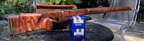

I think linseed oil can produce some beautiful stocks and it is durable.
While Bc'z produces some amazing finishes and I would love to own one. I would be afraid to use it for fear of damaging it somehow.

Yeah, I love this stuff. I have enough to do another stock. I can’t decide what kind to do with it! A friend gave me this hunk. I have to find out where he bought it!
Beautiful stock, it's been fun watching it come to life. Cant wait to see it all put together.

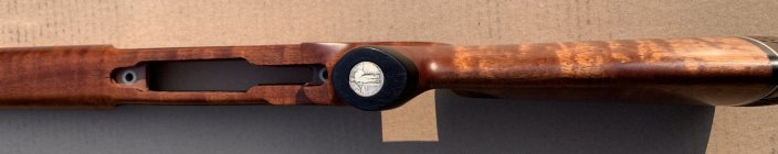

Thanks, guys! I show them to my wife and she just rolls her eyes! On most of my stocks, I epoxy a 3/8” threaded rod thru the grip to just below the action channel. Then I cover it with a Liberty silver quarter.

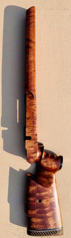

Final bedding:A183B32B-F85B-4EAD-9E82-58D1F344CB5D.jpeg
Final bedding:View attachment 1279606
That's sexy!!
I really like the matt black where you have it taped off.
