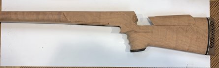

Getting ready for tomorrow cut and glue up session. There will be 2 carbon fibre stringers in these 2 stocks. Should be shaping them come the weekend well that's after I get mesh and plastic down for workshop extension and maybe even have the concrete layed aswell.

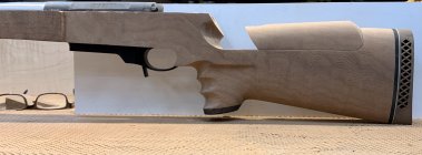

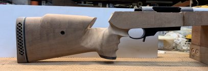

Yes carbon fibre does eat bits up . But I replaceable cutter bits when buying in bulk there reasonably cheap. Carbon fibre adds strength with out adding weight to your stock . Also once finished it will have carbon fibre in the barrel channel area from action forward. These stocks will also have a fibre glass skin on them aswell as the outer timber is lightweight and the same structural integrity as cedr but dents easily. I use a boat building epoxy for gluing all my stocks up .
Glued up blank the tape is used to prevent the carbon fibre from going stringy. Then once it's all set up and glue has hardened up trim off then I run the blank over the jointer to make the top level. Will add pics as I go

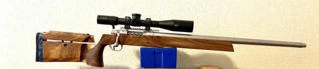

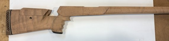

Hey Papa: I used a thickened mixture of West System Epoxy on this one. When it hardens, the color closely matches the wood. I set the pillars when I bed, which gives me my depths for my bottom metal inletting. I can just cut to my pillars instead of constantly measuring.
I got a little further today on the mahogany98AE9A64-E6BF-49D1-BC3C-392F737774FB.jpegFA99C42E-BAD1-4829-B091-C94682CAC739.jpeg stock.
