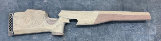

Sanded the recoil pad, roughed in the grip cap and sanded the rest to 220. I have to gear up in full hazmat gear to work on this teak. Not pleasant. Honey do list only gave me a couple hours, today.
I’m waiting on my cheek piece hardware so I can’t finish until it comes in.

Here is an image. The cheek like many is adjustable, the bottom of the stock is flat to provide level recoil on the rear bag. The forearm is 3" wide with an insert on the bottom to allow a pin from the front rest to slide in during recoil. Vents are often added to the forearm to vent the barrel heat from 22 rounds in 20 minutes. The butt stock is often fitted with a recoil absorption butt plate and is adjustable to fit the user.
