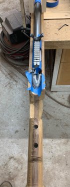

Back to the build, With my pillars set, I cut for the magazine, trigger and safety. Then I flipped it over and used my template to route out for the PT&G bottom metal. I put the bottom of the pillars at the same level from the top of the jigs to make the cut. With the bottom metal in and screwed to the action, I can use a bearing bit to finish cut the trigger opening.

I’m toasty! My shop is 75 degrees. Perfect for bedding an action.

*so you preglue the pillars in before doing the final bedding job? like Jstock
*how do you set and hold the pillars at a certain height?
*what is the block of wood on barrel channel? ive used something like this to level top offorend to gun.
* ive bin using pillars made of devcon for awhile and i havent cared if they stuck out past the action however ill have to do this one like the old days. as you know not much tang on a reminton to cover apillar and still get it substancially glued— ive had them come loose before. you must have youre pillars matched so they are the correct length for your bottom metal?____ more fun to come!

1.*so you preglue the pillars in before doing the final bedding job? like Jstock
*2.how do you set and hold the pillars at a certain height?
3.*what is the block of wood on barrel channel? ive used something like this to level top offorend to gun.
4.* ive bin using pillars made of devcon for awhile and i havent cared if they stuck out past the action however ill have to do this one like the old days. as you know not much tang on a reminton to cover apillar and still get it substancially glued— ive had them come loose before. you must have youre pillars matched so they are the correct length for your bottom metal?____ more fun to come!

1&2. No. I do it all in one. I measure and cut my pillars. (Put everything together and check function. Sometimes a pillar is a little long.) Then I lock them to the bottom of the waxed action with bolts. I’ll spread my bedding compound in the stock, the holes and coat the pillars. Set the barreled action in the stock, press it in and check for level. Leave it overnight.
3. Exactly! The shims under the forend are making it level as clamped. It leaves room to slip in the barreled action.
4. I buy the aluminum pillar blanks 10 pair at a time. I cut them to length on my miter saw using a homemade fixture. Tape wrapped around the bolts keeps the pillar centered. I drill a 5/8” hole for the 9/16” pillars leaving room for the epoxy bedding. Gotta spread bedding in the holes and goop up the pillars. In the morning, I unscrew the bolts and drill out the extra epoxy with a 5/8” Forstner bit, careful not to hit the pillar.
Trade secret: I put a steel washer on the bottom of the pillar before I lock it to the action. The Forstner bit will hit the steel washer and spin it loose, leaving the pillar undamaged.
Plenty of room to cover the pillar in the rear.

thanks for all that good info—

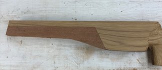

I cut the top chamfer with a 15 degree bit.
Cut the bottom edge with a 3/4” round bit.
Tried a different side cut with a 1” core box bit, then cut the rest of the side with a 3/4” flat bit. I took off 3/16” of wood.
Then I bedded the recoil pad in epoxy and the leopard wood grip cap. It will sit overnight.
