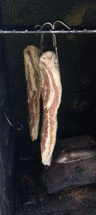

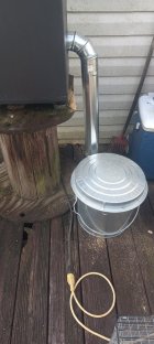

I'm no expert on summer sausage but I've been heavy into cold smoking bacon for 20 years. 200 sounds pretty high to me. Temperature control is crucial and too much smoke will make it inedible. I have the above type setup in my electric smoker, The electric smoker controls the temperature, mailbox controls the amount of smoke.
For bacon I cold smoke (120) with smoke for 3 hours then bump the temp to 175 until internal temp of 165. This bacon is cured with pink salt for 7-10 days prior to smoking.
Yahoo mail is down right now or I would have posted pics already.
Getting everything together and ready to smoke is a lot of work so do your homework, maybe do a test run with a small batch first. Everybody's taste is different and figuring out how long to smoke is hit or miss. My first time doing bacon had be belching smoke taste for a while LOL. Have fun with it and good luck.smoker 1.jpgsmoker 2.jpg
My mail is up here are the pics.
