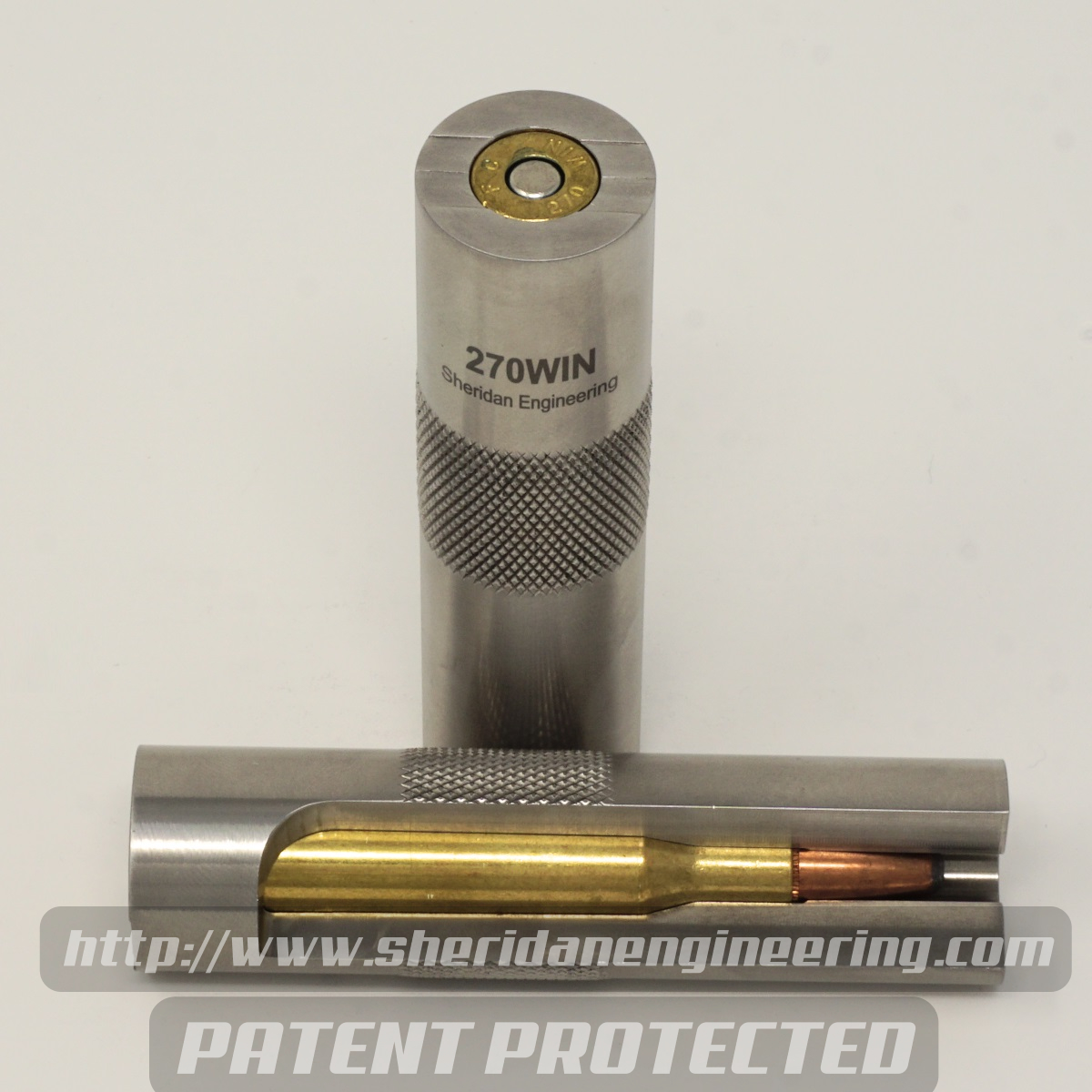

JMO, but if you're going to FL size your cases every time you reload. this is what I use to check my cases with, and it will help you get your die set up for your rifle, a Sheridan slotted case gage, I also use the Hornady tools, but once you everything set up all you need to do is drop your cases in this gage, it's a go/no go gage, if your cases are not sizing properly this gage will show you what's going on with them!
That slotted feature is really nice, you can actually see the fit.
