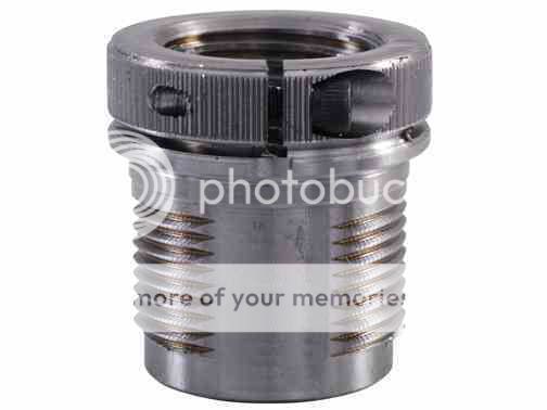

These are the quick change adapters with a die lock ring built in. (#90063). They should let you run the die a little deeper and still secure it. No lock nut on top needed.
