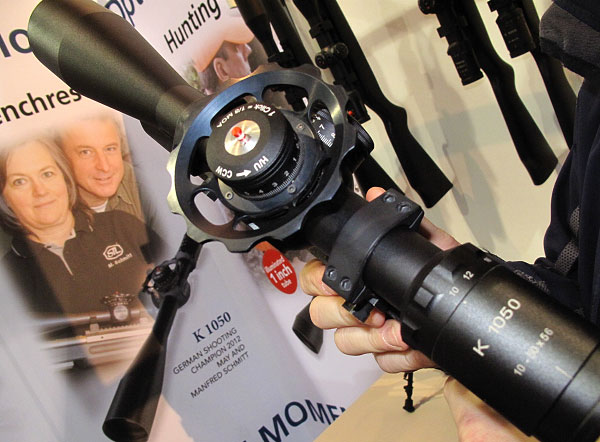

I remember seeing the scope on IWA with the big paralax wheel , indication its initial target segment was likely Field Target
Field Target spawned many of top LR scopes , and one of the main demands the have is as wide and linear as posible paralax in sub 100y span.As they actualy ranage distance to 1Y precise using the paralax
Was similar with Kahles 1050 when it was introduced in 2013 IWA with the big paralax wheel
Yeah there's no doubt The Delta would work well for field target use. Although the wheels make fine adjustments easier, I'm not putting one of those on my scope. Especially not with a left load port on my action. The wheel wouldn't be too bad on the Kahles since the parallax wheel is up out of the way. But I don't think the Kahles really needs it. It has a much finer adjustment at long range.
Its near mandatory for FT as its used as range finding scale not as a finer dial . Much smaller knob wheel is used on March scopes for more paralax fidelity in centerfire. March tried to take on FT with their designs but so far no good enough.
FT is in terms of scope preformance most demanding discipline of all , these guys have things figured out right down to temerature efected scope shanges ,a nd you know silver scopes are one of their inovations as black scopes wander more in terms of paralax han the silver ones that heat up less.
Note on this picture different setings for different temps, those are not because of atmospherics but physical dimension changes of the scope and its internals changing the settings.(low temps strip likely British rig)
The big wheels are not very applicable for centerfire long range shooting or hunting. I suppose it could work for people who do not prefer to use actions with a left or dual port. My intended purpose for the scope is ELR. I wish manufacturers would be more specific on their parallax designs. They all state something like "10 yards to infinity".
