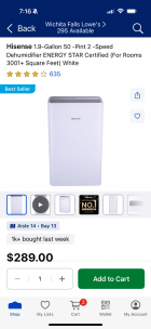

I bought this one 3 years ago at Lowes.
It is in my shop which is an attached garage and it is still going strong.
When the humidity starts rolling in here in North Texas it gets pulled out, plugged in and left on till the humidity rolls out.
I keep it at 30% which is the lowest setting and its runs all the time. I have to empty it twice a day.
With the mini split set at 72 degrees, 75-80 percent humidity outside it will keep the shop between 35-40% humidity.
