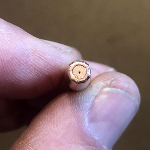

So is that a fmj bullet with a cut in the jacket? And its open back exposed core like other fmj bullets i guess? (Pictures arent very good)
Yea that picture confused me too. The back is a rebated boat tail so the picture you are referring to is likely one of the tip with the tip removed. On impact the tip is supposed to be driven into the core made possible the by the frangible nature of tip after getting a nosering
