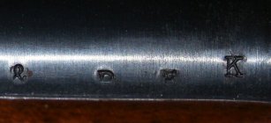

If you do some digging on the web and look for pictures and stories of guns with the barrels still on th‘em so you can get the barrel codes and find the serial numbers you can get probably get close.

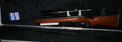

Mine is a sub 600 serial number that I got from a BR guy who wasn’t shooting enough to need a backup. It’s re barreled and will shoot to the capabilities of the ammo and the trigger puller.

Remington Owners,
Remington Year of Manufacture Codes maybe found on the barrel of your Remington rifle [or shotgun] on the left side, just forward of the receiver; the first letter of the Code is the month of manufacture, followed by one or two letters which are the year of manufacture. For shotguns with removeable barrels, the code will be valid for the manufacture of the barrel; maybe for the receiver, as barrels do get switched around.

Yes sir, but not having the barrel we can get close to the era it was produced by serial number.
What would you make of this barrel code? According to the serial 5698 number on the action Remington told me 1959. IMG_1619.jpgIMG_1623.jpgIMG_1621.jpg
