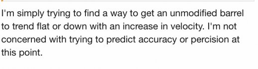

I'm simply trying to find a way to get an unmodified barrel to trend flat or down with an increase in velocity. I'm not concerned with trying to predict accuracy or percision at this point.
Thats a load development and shooting skills topic. Neither of those are pertinent to this goal.
