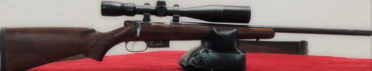

These are my two CZ 527 17HH's. They're both solid little guns with decent wood but as you can see unlike some of you I didn't hit the wood lottery with mine in fact I've never hit the wood lottery with any 527 I've had. All mine have just had ok wood but I've sure seen some factory 527's with really nice wood on them it's just none of them were mine.
