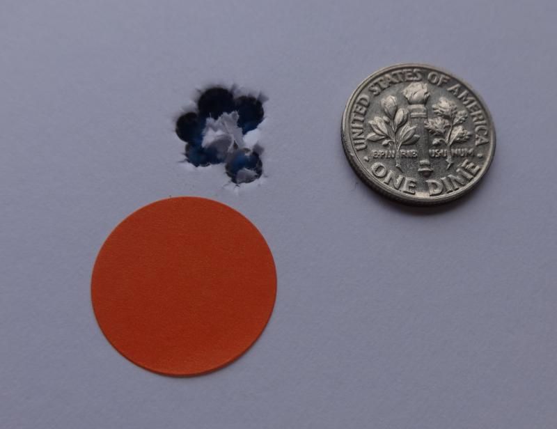

What Lucky said. I have the 527 varmint model in 17 Hornet and it's the most accurate factory rifle/factory ammo combo I've ever owned. This five shot 100 yard group was when it was new (rounds 21-25) and it has only gotten better. Orange sticker is 3/4"
