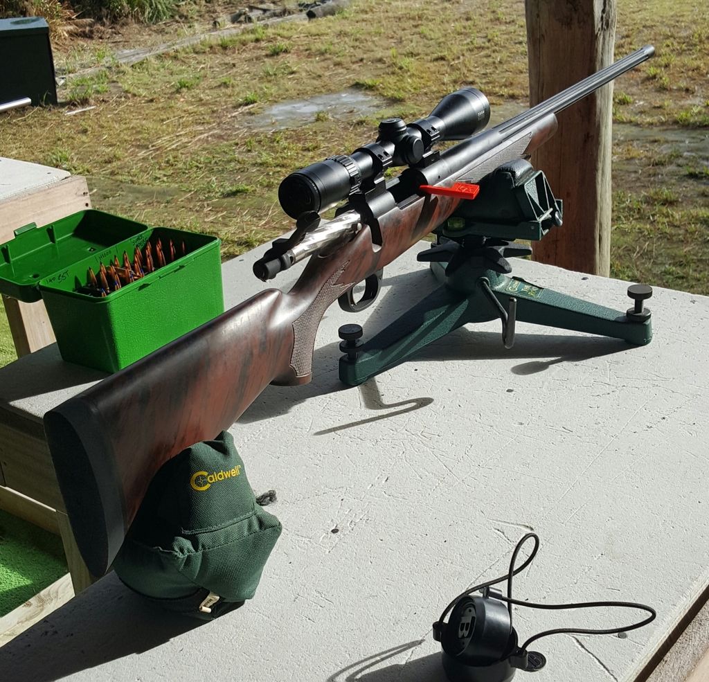

Eternal Student, heres my 7 lb 6.5mm SAUM (loaded and ready to go).
Built on a trued Remington 700 short action, fitted with a Wyatts extended box magazine so I can seat the Berger 140gr hunting VLD so the base of the bullet is level with the top of the shoulder (i am currently using 63grs Retumbo with no compression). Bolt is a PTG spiral fluted with skeletonised handle, M16 extractor and PTG aluminium bolt shroud. Defensive Edge custom bolt release and PTG Oberndorf aluminium bottom metal (standard Remington BDL bottom metal is junk).Lightweight Tally mounts, scope is a Bushnell 3500 4-12x DOA
Barrel is a 24 inch Criterion 1:8 twist fluted, slightly thicker than a 700 SPS contour. Stock is a McMillan McWoody, all metal work Cerakoted black.Gunsmithing down here in New Zealand by Scott Traill (no longer gunsmithing, mine was his last build).
Pushes 140gr Berger Hunting VLD's at 3075fps which is pretty much .264 Winchester Magnum ballistics.

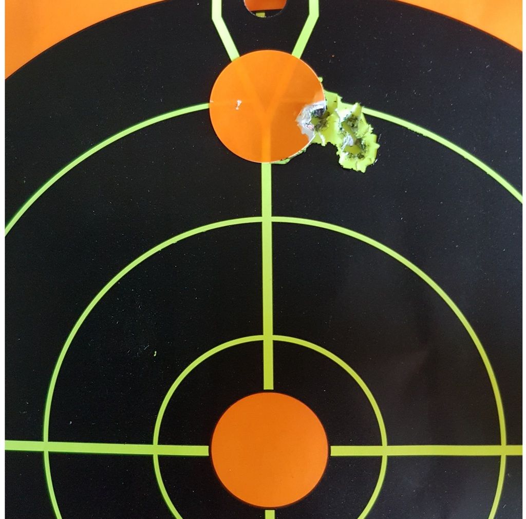

This is a 0.332 MOA group shot off my bipod with the berger 140 hunting VLD at 0.70 off lands. Constantly hovers at 0.5 MOA or better (depends on the operator). As this is purely a hunting rifle then a Remington 700 (with a few custom additions) is all I'll ever want or need. However, if it was for a real accuracy job i'd certainly go a custom action.
