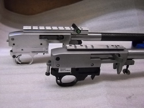

Third, barrel attachment. The MOA and VQ receiver can be had threaded to solve that problem. Or, the Power Custom 1-Piece Barrel Mount Weaver-Style Base lets yu attach the receiver to the barrel.
Two Charger - 10/22 pistol - both shoot under 1/2 MOA with Fiocci SM320 or other good match ammo.
The action in front is an MOA with threaded Duglas barrel and reworked factory trigger.

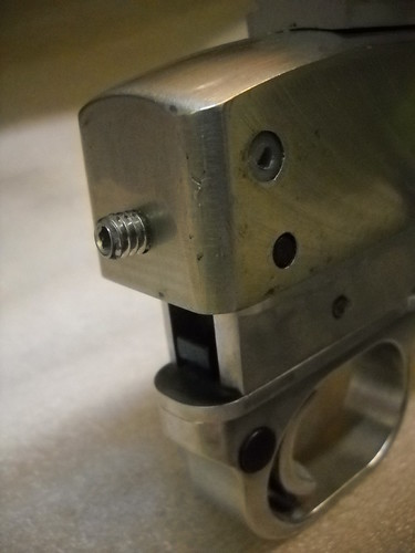

The action in the rear is a factory receiver with a Power Custom scope mount and a cap screw added to the rear of the action to keep it from rocking when shot. It has a Jard trigger and 10" VQ barrel
