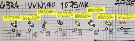

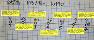

I have 2 custom chambered shoulder fit CBI's and they shoot great. The current CBI Shouldered pre-fit was an off the shelf 6BRA and this thing is amazing. Connected to an Origin action and Trigger Tech Diamond and Revolution BR stock. All barrels and action from Northland Shooters, stock from Urban Rifleman - not bedded yet. Here's the first 4 range trips with different bullets and mostly lower charge, fire forming loads - though the VTac's were pushing 2890. And after 1400+ rounds, a 600 yd match target.
