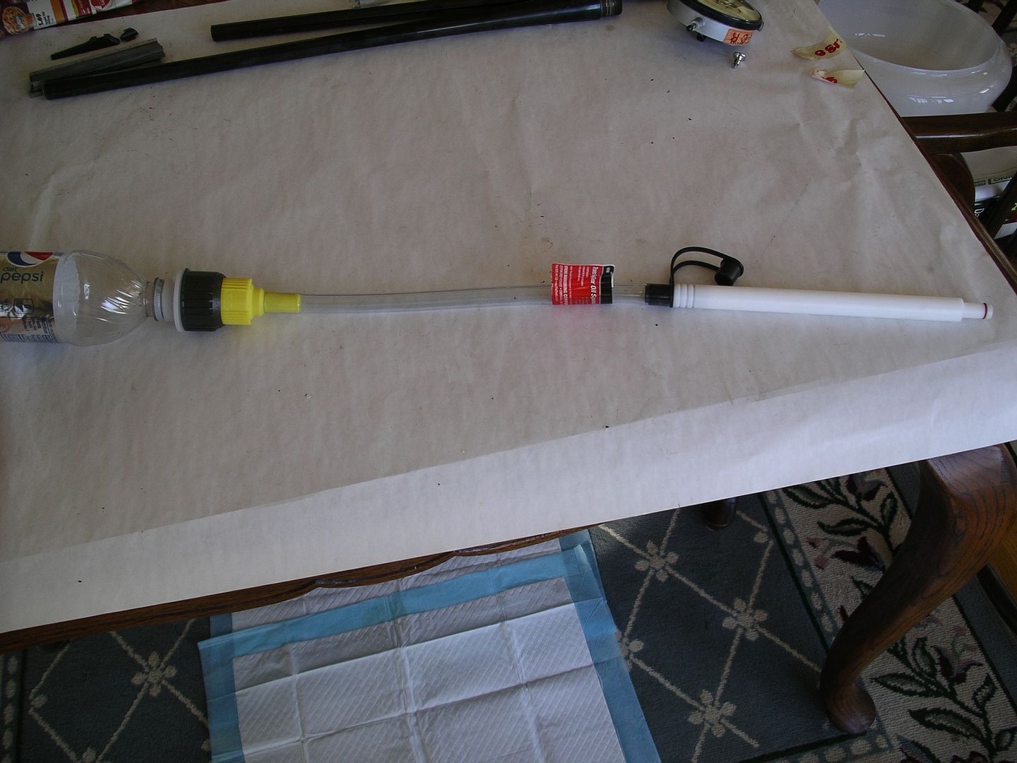

We cooled barrels with 4-6 oz of water down the barrel on red hot p. dog towns, finest custom guns and barrels made. We have used this method for 30 years.
Follow by pushing 4 patches down the bore on a tight punch type jag, NOT a slotted jag. Then dry the chamber, start back shooting.
There is also the benefit of cleaning the excess carbon out, which extends shot strings.
It is just that simple.
Rod guide of sorts to seal the chamber
attachment that goes in the back of the rod guide which sells for $3.00 at most auto parts stores and Wal Mart(quart oil attaches to this):
Oil can attachment goes into the back of the rod guide:
The complete barrel cooling unit:
Pepsi bottle, oil can attachment, plus rod guide
This is a no brainer! ONce we ran out of water on a hot day in S.D., and we used Mt. Dew, and diet pepsi!
