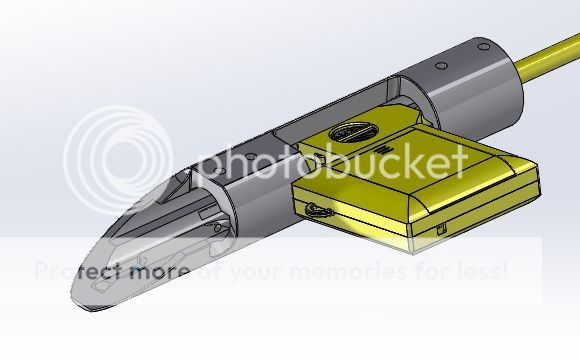

Here are the latest 3D models with a 700 pattern and AR15 pattern receiver with BarrelCool

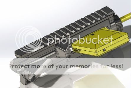

Image below show where BarrelCool would intake air for an AR15 pattern receiver.
I was able to get some cooling tests with a 7mm, 1.25" straight contour, 7mm barrel and BarrelCool. Thermocouple probes are Speer Scientific 800007, attached to the outside of the barrel. Outside barrel temp was taken up to 135-140 degrees by using a heat gun and heating the barrel from the inside of the bore. Once the outside barrel temperature reached ~135-140 degrees F, the heat was removed and allowed to cool down to 100 degrees or for a duration of 20 minutes, whichever came first, with and without BarrelCool. Temperature was recorded in 1 minute intervals and the experiment done twice to ensure the test and data was repeatable. The data shows that Barrelcool took 8-9 minutes less to get to 105 degrees and shows as much as a 11 degree difference using BarrelCool in the same amount of time.
Testing was done indoors, in a 65 degree room and the barrel off the rifle.
