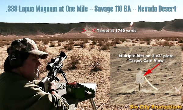

Brand new Forum member Mark Dalzell has created an excellent video showing an extreme long-range shooting session in the Nevada Desert. A 2'x3' steel target was placed at 1760 yards -- yep a full mile away. After a half-dozen ranging shots, Mark scored multiple hits -- and he did that with HSM factory ammo.
The video is very professional, with included latitude/longitude and range conditions. Mark even had a separate target camera, and he uses frame-in-frame edits, so you can see the hits on the 2'x3' target. You'll also get a kick out of the cool ZZ Top soundtrack.
NOTE: Mark also included, just for AccurateShooter.com, a personal audio clip. Mark talks about his equipment and the "rush" he had making hits at such long range.
We welcome Mark to our Shooters' Forum. He created a really nice video that will be appreciated by anyone who has shot beyond 1K, or who dreams about doing that someday.

That is a excellent first post. Did you do any modifications to your Savage, ie new barrel trigger, etc? What kind of scope mount and rings are you using to get enough moa?
Wayne.
As far as the Savage BA110 .338 goes, it's completely stock from the factory. The Accu-Trigger that came
with the rifle feels great. In fact, I didn't change the trigger either which I think comes
from the factory set at 2.5 lbs.
Picatinny Rail came with the rifle with 20 MOA elevation.
NightForce Scope: NXS 5.5-22x50mm, NP-R1 Illuminated Reticle, 1/4" MOA, Zero Stop, Speed Turret
Badger Rings
I had my elevation up to 67 MOA with the HSM and Southwest Ammo.
But when I tried the Cor-Bon (300gr. HPBT / Velocity 2800fps / Energy 5224 ft/lbs.) ammo,
I had to lower my elevation by almost 10 MOA. It was very hot and seemed to have a lot more punch.

That is very neat that you able to have that kind of performance from a factory rifle, very impressive indeed, I am surprised about the 10MOA difference in ammo, that semms like a lot but the proof as they say was on the target ;) Thank's for the update Mark.
