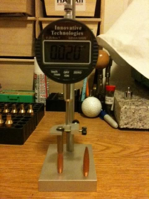

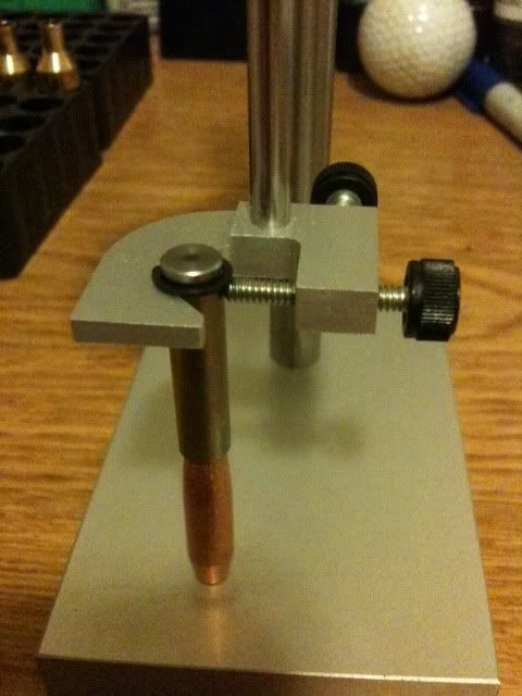

I run a Redding Comp Micrometer Seater, and the stem is easy to remove. I also just picked up this very cool tool from Innovative Technologies, the digital headspace gauge. (http://www.larrywillis.com/)
normal function of the tool can be read about at the website.
I pulled the seater stem out of the die, and the stem has a c-clip on the top. I used this as a stop and reference to secure it to the tool.

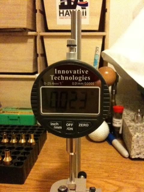

Then I started measuring the bullets and sorting them, most where in a range of +/- .001", I made three buckets one with the most will be used for match. One with -.001" and the one with +.001" will be used for practice, and the ones that were way off will be for foulers.
This is one that was on the money.
This one was one of the out casts .003" off
Interesting thing... the ones with the most consistency weighted in at 106.9, almost all of them. The + or - were between 106.8 and 107, and the long ones were 107.1.
Loaded up about 25 rounds and pulled the stem out again to check OAL. Pretty much dead on the money. a few were .0005 to .001 off, but I think that is pretty darn good. ;D
Now the bullets are seated at a consistent ogive to lands, AND at a consistent depth in the case. Will this give me better consistency overall?
Want are your thoughts on this?

Heavies,
My thoughts on this??? I think your a genius, I have this Larry Willis tool and it does a excellent job on setting up a die for shoulder bump, which is the sole purpose why I bought it and it does a decent job of measuring coal but I hadn't found a good way to just measure bullets,...until now, that's just down right ingenious. Thank you I will give it a try tomorrow, this should be the answer to your problems fitter, $90 of the best spent money on re loading equipment to date.
Wayne.

No problem! I just hope this theory pans out. I haven't had time to test this yet, and Ill probably never be able to test this out to the fullest.
I was following this thread, the one on consistent shoulder bump, and the Larry Willis tool. Bing, the idea popped. Purchased the tool; kill two birds with one stone. ;D
