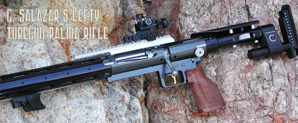

Boyd Allen and many here give very good advice, "BUT" the advice is slanted from a benchrest shooter perspective.
And what I took offensive to was the insult to the late Jim Hull, German Salizar and Kevin Thomas who were and are at the national competitor level. And all of them full length resized their cases and thought "The rat turd in the violin case" was a humorous way of saying they did not neck size.
So again, not every one here is a benchrest shooter or only neck sizes. And I felt Boyd Allen's statment was self centered and insulting to shooters competing at the National Level. And both Jim Hull and Kevin Thomas worked in the Sierra balistic test laboratory and know how to make accurate ammunition.
Below is something I copied from German Salizar's website before it shut down. And below he is answering a question about partial full length resizing, and "WHY" full length resizing is better.
"a full-length sized case in which the neck is also fully sized. There is clearance at the neck and in the body of the case, the closest fit anywhere is the bullet in the throat. If the neck to bullet concentricity is good (although it needn't be perfect), then the bullet will find good alignment in the throat and the case body and neck will have minimal influence. Let's not forget that the base of the case is supported by the bolt face or the extractor to a certain degree as well; this is yet another influence on alignment. As you can see, there are several points from base to bullet that can have an effect. My procedure is to minimize the influence of those that I can control, namely the case body and neck, and let the alignment be dictated by the fit of the bullet in the throat and to some extent by the bolt's support of the base. Barring a seriously out of square case head, I don't think the bolt can have a negative effect on alignment, only a slightly positive effect from minimizing "case droop" in the chamber. Given that a resized case will usually have a maximum of 0.001" diametrical clearance at the web, this isn't much of a factor anyway.
In conclusion, I believe that allowing the bullet to find a relatively stress-free alignment in the throat by full length sizing (including the neck) and turning necks to enhance concentricity gives the bullet the best probability of a well-aligned start into the rifling."
The Rifleman's Journal
Germán A. Salazar
And again at Mr Salizars website is where I read for the first time Jim Hull's humorous full length resizing statement.
"The cartridge should fit the chamber like a rat turd in a violin case"
Now go back and read the OP first posting and ask yourself is the OP really ready for a custom die so he doesn't have to adjust for shoulder bump in two AR15 type rifles.
