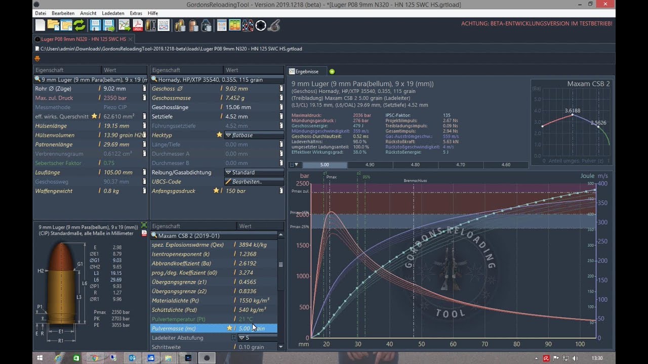

My suggestion would be to use a slightly different approach; i.e. buy/obtain yourself some reloading software. I use QuickLoad (top link), but there is also GRTools that some members here at A.S. favor (2nd link).
Regardless of which you use, what these programs offer are a very wide range of preset, selectable cartridge, bullet, and powder files. Some of the variables, such as powder burn rate, are user-adjustable, to allow the user account for Lot-to-Lot variation in powder, temperature, different primers, etc. Basically, to get started one needs to input a series of measurements from their actual loaded rounds (i.e. bullet length, barrel length, COAL, case length, case volume, etc.). Using a preset powder burn rate for the powder selected from the menu, the program will provide outputs for a given charge weight such as cartridge fill ratio, pressure, barrel time, and velocity. Because the programs contain a only single preset powder file for any given powder, the initial program output values may or may not be close to the real-world values. That is because of Lot-to-Lot powder variation, primer brisance, case volumes, etc. All one need do is to use a suitably reduced load (for safety reasons), then go out and determine actual velocity for a few loaded rounds. Once back home, the user can then adjust the program for actual temperature, then change the preset powder burn rate value until the predicted velocity matches the actual recorded average velocity. I refer to that process as "calibrating" the reloading program to a specific setup. Once the program has been calibrated to a given setup, the predicted responses (outputs) are usually quite good.
I mention this here not only to bring the innate value of these reloading programs to your attention, but also because you could actually do something similar without actually having one of the programs. For example, you pick a charge weight common to the various reloading manuals you have for your specific cartridge/bullet weight/powder combination, but making sure that the selected charge weight is at the low end of the range. You load up a few rounds, then determine actual average velocity from those loaded rounds. Once back at home, it should be fairly easy to determine if your actual real-world velocity results line up with the values reported in one manual versus another. This is a "seat of the pants" kind of approach, but one that would very likely allow you to rule out using the load data published in some of the manuals that clearly did not match up well with your actual test loads and therefore might be reporting MAX loads that are too hot. The only real downside to this approach is that it does require loading few rounds and making one extra trip to the range before actually starting the load development. Because of the way you already do your testing, it may not offer any real advantage to you other than peace of mind if some of the MAX values reported in your manuals seem excessively high. With the reloading software, this calibration step is essential for good results. In any event, best of luck with the process and give those reloading programs a look. Most of the people that have them find them to be extremely useful.
