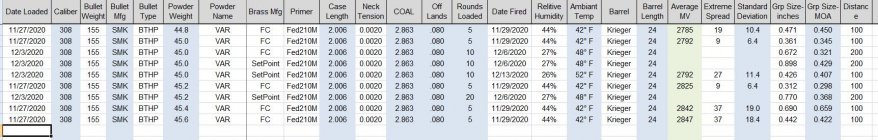

I've used more than 44gr of Varget pushing 155 SMK's and no problems with cases having less less volume than Winchester brass (see pic below). If I was using Winchester brass, I'd have less pressure and velocity than I got. But, it's ALWAYS wise to start low and work your way up.
