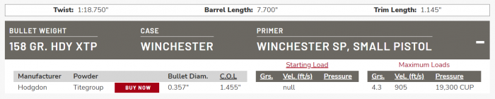

Here is the +P version with a jackted bullet for comparison. You can see it takes up to 4.3 grains to get up to 19300 CUP from a baseline at 3.9 grains giving 15900 CUP. That is a 0.4 grain increase, and still leaves room in the case.
A S&W 64 is rated for +P loads and was considered a M&P rig, so you will have plenty of safety margin to seat where the bullet was designed as long as you work up using a chronograph, while keeping with 38 Special pressure.
