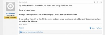

Using Peterson Brass and Whidden Non-bushing dies. I just fired them for the 7th time. I anneal every firing and size only enough to bump the shoulders 2 thou everytime. Never had clickers/heavy bolt lift with this load before. I'm using an Impact action and it has a significant catch right before the bolt comes all the way up. Is this something I should get into contact with Whidden about? I don't want to just band-aid the issue and would rather have a more permanent fix.
The load I'm using is 49.2 grains of H4350 under a 180 grain berger hybrid. With my 26" barrel I'm getting right at 2710 fps. It has never been a hot load in my rifle, no ejector marks, cratering, or overly excessive case head expansion.
See below: from Rope2horns in this thread.
I am using a Whidden die also for my .284 Shehane. I polished out the back end with a "Norton 01727 Gray Norton Wool Pad" from Amazon (about 2"x.6") affixed to a nylon chamber brush in a batt. drill motor. I ran it in and out about 3/4" for less than 5 min. and that took care of my problem. My issue was somewhat more critical than clickers so this fix ought to work for you.
