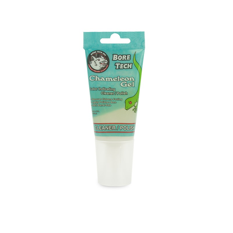

Boretech chameleon is less aggressive than JB.
KG 2 is somewhere between Flitz/Iosso and JB.
