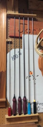

I built a "stands in the corner" one out of 4" PVC pipe with a toilet flange (new one ;)) as the base with smaller 1/4" & 1/2" pvc pipes inside the 4" pipe to keep the rods seperated. Holds about 8 with ease.

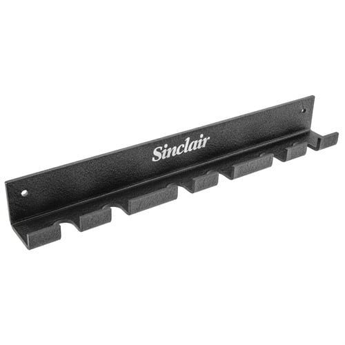

I’ve had a couple of these for a few years now…
…but good-googly-moogly, I don’t remember them being that expensive!

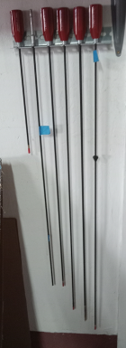

I took 2 2 inch long sections of 4 inch in diameter pvc pipe and mounted those horizontly about 32 inches apart under a shelf. Drill a hole in one side of the pvc to fit a screwdriver thru and a small hole on the other side. Put a screw in the small hole and use the larger hole to drive the mounting screw into the wall studs
Lay the cleaning rods in the pvc bands sideways. By mounting under a shelf you dont lose storage space and this also avoids eating up floor space that way. We all need to maximum room for our "stuff"
