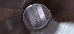

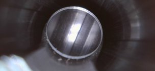

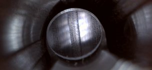

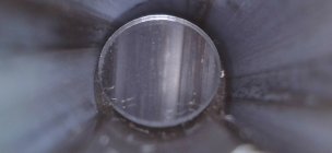

Well, I did strip it all out and found pitting under the fouling. A lot of it. So, now I'm second guessing my decision.
Just past the leade. Same approximate location. All 3 photos.
What we see in post #8 is what was under the copper and carbon. It was a 5 hour process to get it all out.
