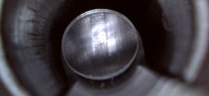

No idea on round count. 6BR. I've seen fire cracking. That would be back here or slightly further back.
I don't see throat erosion. Just corrosion damage from excessive fouling left in too long.
is this a gun youre thinking of buying?
Worst case scenario -
If so just factor in the price of a new barrel, chambering etc and see if the price is right then compared to starting from scratch
Past that point. It's my problem now.

I'd shoot it now, see what the target says, then decide what next. If its really bad (in the bore and on the target) buy some Tubb Final Finish - or put the money towards a new barrel.
Not sure what that pic looks like to me...maybe some fire cracking in the grooves and some (well-burnished) tool chatter on the lands. As for corrosion damage

2. You apparently haven't even shot it yet (what I'm reading between the lines). Before you order a barrel or write this gun off, I'd shoot it and see what you've got. Didn't you say it was "reported to shoot well"? I've seen some fugly barrels shoot great. You can't judge a book by its cover and all that...
Other than the small amount of pitting, it looks pretty good. It's doubtful that the pitting will cause any accuracy issues. I've had barrels on BR guns that looked herkier than that, yet still shot at a competitive level and won in registered NBRSA and IBS tournaments.
Not every BR competitor cleans the barrel to bare steel. Many clean just enough to maintain the accuracy and keep a stable tune. The one downside to that method is that occasionally, it should be cleaned to bare so that pitting doesn't develop due to corrosion. It's possible that's the scenario with your barrel. By not shooting it in as-received condition, a valuable learning opportunity was missed. But assuming it's a well built gun, the barrel will tell you what it wants.
Brushed and cleaned with bore solvent.
