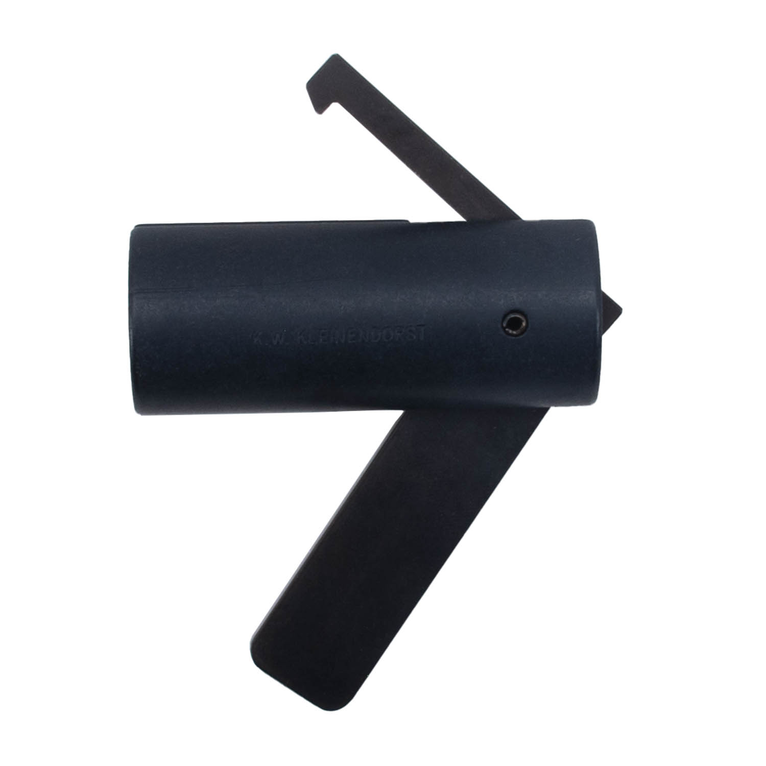

youre probably right about that jd— but i take my bolts apart every time i load for that rifle. thats usually 20 to 25 rounds - i do it to check my ammo on a stripped bolt, but also gives me a chance to check the bolt bore which i do. with an action you can get a kleindorst tool for its easy. more people outta do it.
