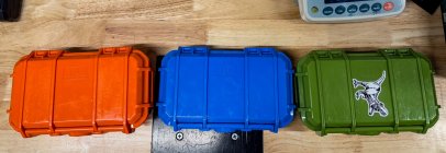

Fellows... OT but.... Anyone find a little carrying case for these expensive "tools" we have? Maybe a small pistol case?
I really like the Seahorse/Evergreen cases with pluck ‘n pull foam. The #56 fits the Garmin and Athlon units, while the 1” deeper #57 fits the LabRadar LX. These fit the chronographs, their tripods, an ARCA or Picatinny gun mount arm, a battery pack, and their charging cords, and offer waterproofing as well as impact protection. These are $30 with the foam on Amazon. Scheels sells a rebranded version with topo-map camo black shell with laser cut foam inside (only holds unit, tripod, and cord, no gun mount slot) for $40.
I keep the charging cords curled under the tripods, and I have a “credit card” shaped/sized portable battery pack laying underneath the right side foam.
# 57 with LabRadar LX at our left, #56 with Garmin at middle and #56 with Athlon at our right.
The Athlons do include a rigid softshell case, which is quite nice, but it doesn’t have room for the gun mount. Many folks may consider that a $30 advantage for the Athlon.
