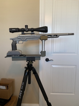

With all the new chassis stocks for various PRS rigs and other applications... has anyone tried a chassis stock that they would recommend for a bench prairie dog rig?
I was thinking that the weighted versions might lend themselves well to a rig to be used on a swivel table off a bipod. This rig would use a heavy bbl profile, and a repeater R700 clone action with detachable box magazines. This project will be a 204 using 40 VMax and 39 SBK.
I see some competition stocks that offer kits that include weights like the XLR ENVY Pro JV, and the MDT ACC, for example.
Any favorites? Ones you tried and didn’t like?

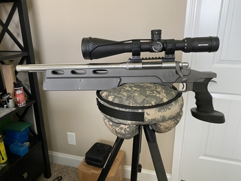

I really like my chassis stock now. It's highly modified from it's original design and works out great.
Wow, I can sort of see a logo, but I’m not versed in chassis, what chassis did you start with?
What cartridge does this use?

This started off as an Accurate Rifle Systems stock. As seen below, it came with a compartment on the forearm where additional weight can be added. Also on the rear a should stock could be added. I had it made without being able to add a shoulder stock. After trying it out, I did not like it at all with the drop down section on the front area for added weight. It was bulky, didn't setup well for shooting in the field, etc. The side panels were not flush on the bottom so that also cut down on the bearing surface on the front rest. Some shooters really like the stock, but I didn't so I had the bottom area milled off. Now the stock is lighter and much easier to setup.
The barrel on the previous post is setup for .223 the barrel on the bottom is setup for .20 Vartarg. It's a REMAGE setup.
