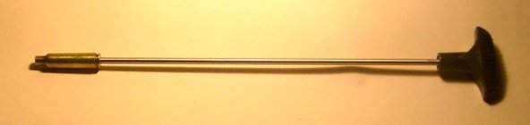

Assuming a clean cut chamber, how much difference do y’all think there would be measuring to the lands using the Hornday L&L tool vs the stripped bolt method ?
I have never used the hornady tool but I would say it’s dependent on how hard you pushed the bullet into the lands. Stripped bolt method is a pain getting the ejector out of a savage bolt face like I shoot. Or it is for me anyway
Please please try it. I’ll say it one more time it’s aggravating the first few times to get the “feel” for it. If you go too deep simply close the bolt or tap it out with a rod being carefull at the muzzle
Actually, I have some wood dowels over in the corner that I picked up to use when I use the Hornady tool. I think that I may try a modified version of your method with the rifle laying on its side. Instead of dropping the round I can tap its base with a dowel and feel for if the bullet is stuck in the rifling with the dowel, which I will probably wrap on its end with tape so that it is better centered on the bullets meplat. (But I will try your method first)
That could work but I use the gravity/weight of the case once the bullet touches the lands it will hold itself in chamber until removed. Seat the bullet only a couple more thou and go again. It’s very repeatable but it helps to know roughly where they are as trips back and forth to press gets old fast as well as in and out of the chamber with your pinky. You could do it the same way with a dowel rod I suppose
I think whatever method you use, the actual measurement means very little but being consistent with your method is what's important. If your method gives you the same number reliably, go with it. Actual numbers are different for every gun/tune and hence, it's just a point of reference for conversation purposes only. I really wouldn't put much value into which way is right or wrong as long as your way gives YOU repeatable numbers.
I use a wood dowel or coated cleaning rod inserted from the muzzle. You push with the hornady tool and the dowel. By working both back and forth you can feel where the bullet is entering the lands. With the hornady tool alone your actually at a hard jam when it stops. Also fwiw precision rifle blog has some data on testing for jump in regards to accuracy. I believe .060 off was found to be the most forgiving.
