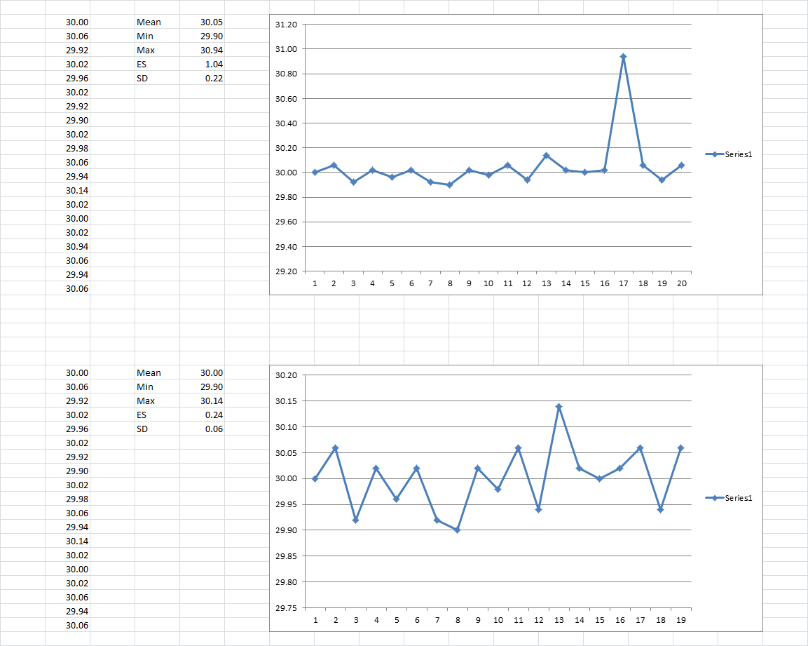

Next was 4831SC another stick With the CM set to 30.0 AVG was 30.05, STD DEV 0.22, MAX 30.94, MIN 29,90, ES 1.04
Wow! It seems very strange indeed that one reading can be *so* far off without registering - it is 9 units of readability from the mean! How can this not register on the CM balance? Is this repeatable?
I've seen errors where a FX-120i has a spurious zero shift of 0.5gr, causing an over or under charge by 0.5gr with an auto dispenser, but this is immediately apparent when you replace the pan, so that doesn't appear to be what's happening here. Below is a comparison of your data with that huge error included (top) and excluded (bottom) - not to the same scale, of course!
