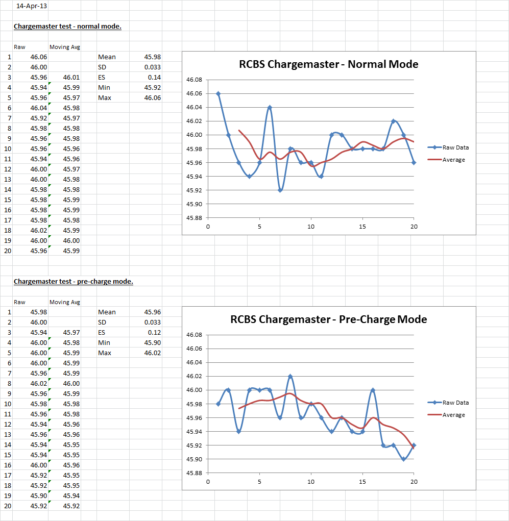

I had similar results when I was testing a CM with a FX-120i back in 2012/2013. 90% were within +/- 0.05 and 100% within +/-0.07. The CM had a drinking straw and everything was warmed-up for at least 24 hours in a fairly temperature-stable environment, anti-static precautions etc.
I was actually looking at whether CM accuracy and speed could be improved be 'pre-charging' with a thrown charge, and just using the CM to trickle-up. The test was simultaneously a success and a failure. By preloading, the tube was kept at low speed, reducing clumping; this appeared to reduce the variation either side of the mean (to perhaps 0.03 or 0.04), however, as you might expect, it also appears to have defeated zero-tracking, so drift accumulated and the overall variation was no better (with the potential for unchecked drift leading to much more variation). I had some ideas for other tests, but by this time my own dispenser was up and running so I stopped working with the CM.
