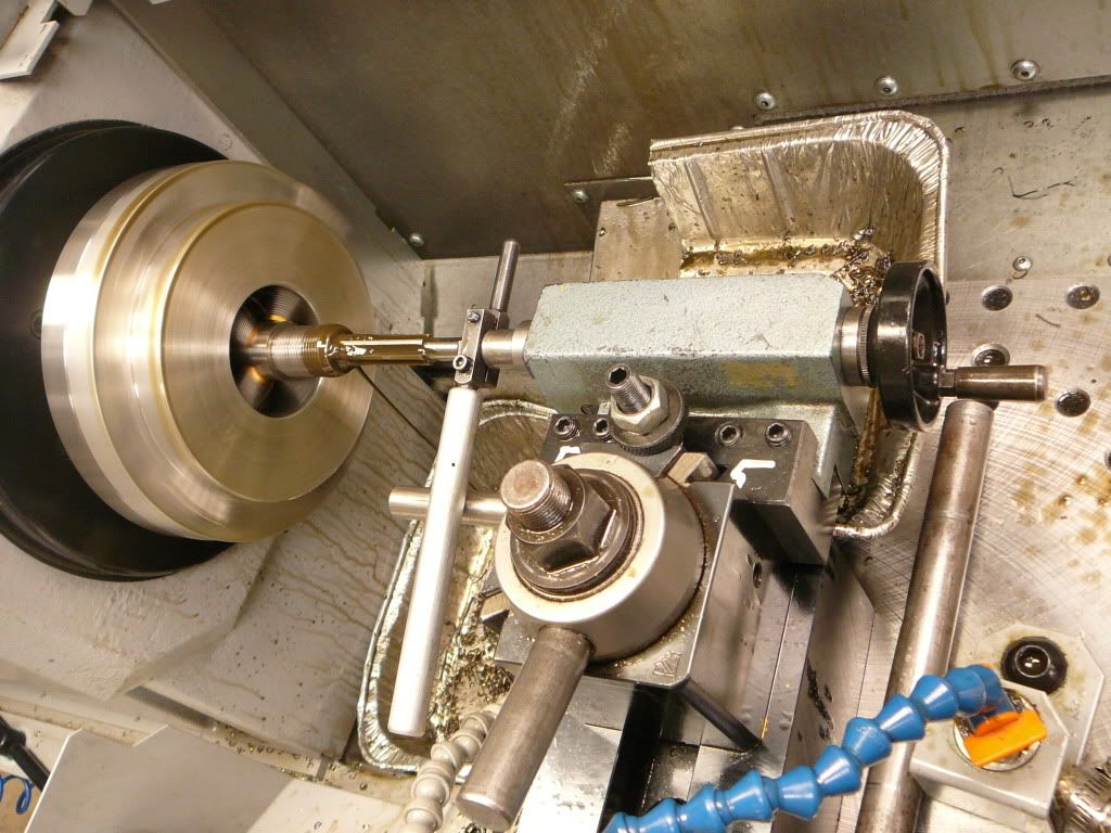

Dave tooley chambers using his carriage. His set up is a small tail stock milled down to fit is tool post holder. I've seen him post pictures of it.
Here is Dave's setup...
