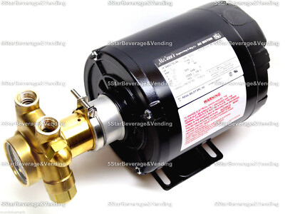

Proconn is the de facto standard for carbonator pumps. I got mine used on ebay for $50 though. Maybe keep an eye on ebay until a cheaper one comes up.

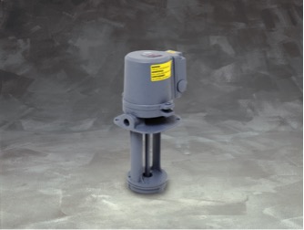

I thought the typical lathe coolant pump was designed to run water based coolant vs cutting oil? I know that the supplied coolant pump on the PM 1440 GT won't run continuously for more than about 10 minutes when pumping oil without throwing the thermal breaker. I like that $179 system you linked to, but will it hold up to 30 minutes of pumping cutting oil?
imersion vs suction
two different styles
Nuttin' fancy here. Homemade tank with baffle inside to keeps chips separated. Filter system in place. Used to use standard coolant pump, but did not make enough pressure. Carbonator turned down is the ticket. Pump on take is just used as a siphon tube lol. Gretan cup. Got a ball valve to limit flow and a quick cut off when things go haywire. One thing that I would like to add is a foot pedal on the pump. That would come in handy.

I ordered the procon motor/pump combo.
FWIW My 1440GT has an immersion pump that looks exactly like what Dave linked to a couple times. I won't chamber with that, but I am going to run some oil through it and see if it's good'nuff for the small parting jobs I do.
In that case, this one looks like the easy button for anyone system:
I would confirm it's an immersion style pump.
I have a 5' head height as it was the easiest route for the oil line from the tank. If I dropped it down I'd get more flow but I've never wanted more. More flow means I pump more onto the floor when I have a brain fart.
Here's a pic of my muzzle setup. In hindsight I would use a ball valve on the oil line as it's either open or closed. The blue line is air coming from a foot valve into a needle valve to control air flow. About 65 PSI Both lines tied together then into the rotary union. Both lines have check valves.
