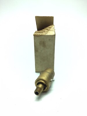

Couple questions...using steel screws for the muzzle fitting isn't damaging the barrel? And which part is the rotary union? Looks like all compression fittings to my novice eye...
Yes. All re usable fittings. I have magnets in the pan. Was just going to put a screen on top to catch the larger pieces.
The screws i made with brass tips.
I also have made adapters to thread onto muzzle brake threads. And the other and a #6. Jic fitting.
After i see what improvements it needs i will likely bend out some custom catch pans.
The rotary union is from a pressure washer IMG_7729.jpegIMG_7728.jpegIMG_7727.jpeg
Keep in mind also that as pictured, there's no adaptability for barrels of different lengths.
When you change out the union, consider making up a longer length of hose (assuming it's quite flexible) that'll reach to a barrel at the end of the spider. I'd use 90 degree fittings at both ends leaving a "loop" of hose that'll be infinitely adjustable to any barrel length. JMO.

The whole arm slides. The barrel in there was 34 inches. And the arm will slide all the way up for a 22 inch barrel.
