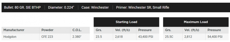

Any new info on CFE223 with 80gr bullets in an AR that folks would like to list. It works really well in my 28" bolt-gun barrel with 23.5gr and 80gr SMK or Berger, but am wondering about the same load in a 20" AR.

I have a Rock River X Series AR in 223 and thinking about trying some CFE 223 in it. It has an 18 inch barrel with 1x8 twist and really likes Varget with 75/77 grain bullets. My problem is I’m running low on Varget and just found some CFE223 that I can lay my hands on. I’ve searched this site and read many posts on this powder with very mixed results. I know the only way to see if my RR likes it is to try some which I plan on doing. Would appreciate personal experience with this powder in 223’s.

For the heavies you suggest starting at 24.04 grns should work
I think I use 25.0-26.0 for Sierra 69's
I've been using 25.0 grns lately since I rarely shoot the AR past 100 yds anymore
When I used to shoot 600 yds with it
I would load it up slightly at 26.0 grns
the 77 TMK performed well out to 740 yds (furthest I tested it) seem to remember 12 feet of drop)
But you could punch a Rock chuck from that far away with it
