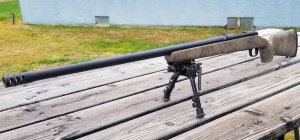

Prep work is key. Other than that its pretty simple. I gutted an old non working upright deep freeze and wired in a range element in the bottom and use the top rack to hang parts and barreled actions from. Takes about an hour for it to get up to temp but it maxes out at just under 300 degrees which is perfect. I also use a simple cheap air brush from Harbor freight that is about 10 bucks and works 10 times better than the $200 one I bought from Amazon when I was first getting into it. Use it 5 or six times, throw it away and go buy another one.
