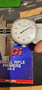

G'day all its been a long time since I had to buy primers as I have heaps but decided to grab some 450 and br4 and was surprised at them piercing so measured the cup thickness and it came up at 0.016" instead of the supposed 0.025"
Just wondering if anyone has come across the same thing .
I figured I would post this for reference.

The primer is a new one cut in half with side cutter's and it measures the same as a decapped fired one .
And it is the wall of the primer.
