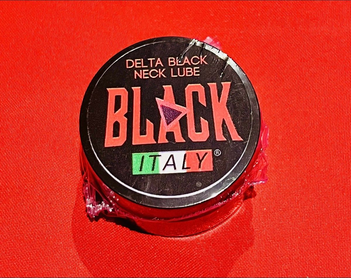

New kid on the block for those that are interested.
I think we all come to realize at some point that we can’t buy it all. lol!
I can’t find any SDS info on this new product?
