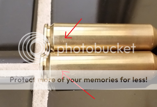

Case head separation causing "nick" in chamber wall
Alex, I decided to leave it. I simply removed the carbon and copper. The nick is very shallow so I don't forsee it being an issue.
I am/was trying to extend the brass life. Brass is Lapua. I am quite pleased with the amount of life I got out of the brass. It really is time to retire the brass as I am very confident that the case head separation was due to the volume of firing the case had on it. I didn't keep track of how many times each case was fired. It could have been that this particular case was fired MANY more times than the rest.
All other rounds fired just fine and were sized at the same time so it wasn't excessive headspace. I have done that before in my tactical rifle and scrapped about 80 pieces of brass. That incident was about 0.008-0.010 of shoulder bump, which resulted in case head separation. I normall bump my shoulders 0.002".
I am usually good with identifying case splits, I cull out loose primer pockets and also try to inspect for signs of incipient case head separation. Nothing really shouted out at me at the time I was doing brass prep. I don't do the paper clip method. I usually try to look for faint lines just above the case head. This was the first case out of about 300 cases in circulation that has done this. I am just glad it wasn't worse.
Ehh, I would guess that many others have had case head separation for the same reason. I know I have in two different rifles. It's hard to change components when you get a good performing load. You just don't know what the next batch will do and it is so hard to take that chance once you finally get things clicking so well.
I really don't think you were in any danger and you're not exactly a novice. ;)
From a casual look at the picture I would say the chamber cut is sloppy and the spot in question was done during the chamber cut and filled in with fouling from shooting.
negative. chamber was cut fine. fouling normally does not travel down that far on the case when firing in a bolt action. Carbon fouling is usually only found on the neck and maybe into the neck/shoulder junction.
How often do you anneal if I may ask?
every 1-2 firings. 3 if I am really lazy.

I had a similar occurrence with my 280AI...except the mark I had was a little bit worse than yours. I shouldered back and rechambered, but if it was barely marking the brass I would have let it go. Mine actually caused a bolt click and a little harder extraction.
*** UPDATE ***
Just an update, as mentioned, I cleaned up all the brass and carbon from the chamber wall as best as I could. I went to shoot the gun. Same load, same everything.
NO issues whatsoever. There is only a real slight marking on the case, but it is hardly noticeable and you cannot feel it unless you really try.
After about 5 rounds of fouling from a clean barrel, gun went back to shooting what it normally shoots. Again, this is a 284 Shehane, 56.3gr H4831SC. 10K off the lands (.235 FB), 180 hybrids. Going about 2880-2890 fps in a 30" brux barrel.
4 shot group at 100 yards.
