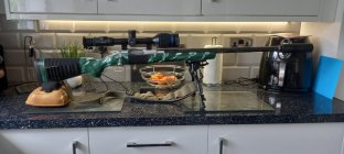

This is a proof barrel,DPT sound moderator,the mod weighs 194 grams.the Thermion 2 XQ50 weighs 2lbs.my swarovski is half that weight.without bipod its a light rifle.i cannot complain about the proof barrel it's a real tack driver and the Foxes don't like it.
