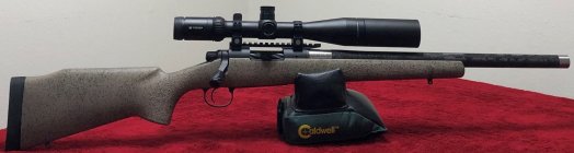

There's nothing lightweight about CF barreled builds. My 6mm Creedmoor is on a trued SA Rem 700 w/fluted bolt, 20in Proof CF barrel, Vortex HS-T 4-16X44 scope which is a fairly light optic, NF 20 MOA rail and NF .885 UL rings, McM Varmint stock, and just the scoped rifle, no extras, it weighs over 9lbs as it sits in this pic. With the SAS Barricade suppressor it's 10lbs not including ammo. The SAS Barricade weighs 12.2oz
